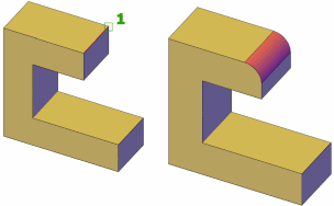

You can select more than one edge. Enter a value for the fillet radius or click and drag the fillet grip.

Select an Edge
Specifies one or more edges on the same solid body to fillet. After pressing Enter, you can drag the fillet grip to specify a radius, or use the Radius option.
