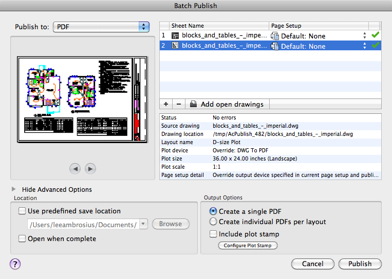

Displays a preview of the selected layout in the Sheet list. Click the Next and Previous buttons to preview another layout in the Sheet list.
Contains the list of drawing sheets to be included for publishing. Click the page setup column to change the sheet’s settings. Use the shortcut menu to add sheets or make other changes to the list.
Combines the drawing name and the layout name with a dash (-). Drawing sheet names must be unique within a single PDF file.
Displays the named page setup for the sheet. You can change the page setup by clicking the page setup name and selecting another page setup from the list. Only Model page setups can be applied to Model sheets, and only named layout page setups can be applied to named layout sheets.
Displays the status of the sheet when it is loaded to the list of sheets.
Adds and removes layouts from the Sheet list.
Displays the Select Drawings dialog box (a standard file selection dialog box), in which you can select drawings to add to the list of sheets. The layout names from those files are extracted, and one sheet is added to the list for each Model and named layout in the drawing. You can use the Add Content list to specify to extract the Model layout only, named layouts only, or both.
The initial sheet names are constructed from the base drawing name and the layout name or the word Model separated by a dash (-).
Deletes the selected sheets from the list.
Adds the Model layout and all named layouts from the drawings that are currently open.

Displays the following information about the selected sheet: status, source drawing, drawing location, layout name, plot device, plot size, plot scale, and page setup details.

Displays additional options that are available when publishing to PDF files.
Specifies the location to save the PDF file to and display the PDF when publishing is complete.
Specify the default location to save the PDF files to. When publishing to a single PDF file, you can specify the location of the file after clicking Publish as well.
When publishing completes, the PDF file will open in a viewer application.
Specifies how the layouts should be output for PDF files and if a plot stamp is included on each layout.
A multi-sheet PDF file is created that contains all the layouts in the Sheet list.
A single PDF file is created for each layout in the Sheet list.
Places a plot stamp on a specified corner of each drawing and logs it to a file. Click Configure Plot Stamp to display the Plot Stamp Settings dialog box, and specify the content and look of the plot stamp.
Starts the publishing operation.
To display information about the published sheets, including any errors or warnings, click the Plotting Details Report message balloon to displays the Print Details dialog box. This information is also saved to the Plot and Publish log file.
