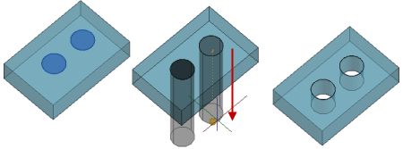

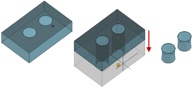

Push a Hole Into a 3D Solid by Pressing or Pulling
  1. Create a circle or other closed shape on the face of a 3D solid object.
  2. At the Command prompt, enter PRESSPULL.
  3. Click inside the closed shape or object and drag the cursor through the interior of the 3D solid object to create the hole.
  4. To undo the previous steps without exiting the PRESSPULL command, enter u (Undo).

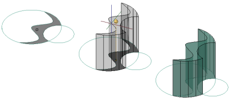

Create a Solid Object by Pressing or Pulling a Bounded Area
A bounded area is an area that contains no gaps. It can be formed by two or more overlapping objects.
  1. At the Command prompt, enter PRESSPULL.
  2. Click within any closed area that is bounded by coplanar objects or edges.
  3. Drag the mouse to establish an extrusion direction.
  4. Do one of the following to complete the extrusion:
    • Drag the cursor to display height of the extrusion. Then click to set the distance.
    • Specify a distance and press Enter.

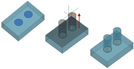

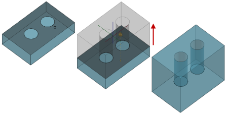

Press or Pull Multiple Areas or Objects
Objects used for a multiple press or pull operation must all support the same type of behavior (extrusion or offset). The extrusion distance for all objects is based on the change in the last object you select.
Pressing and pulling a single area
Pressing and pulling multiple areas
  2. Do one of the following:
    • Press and hold Shift as you select the object, face, or area.
    • Enter m (Multiple), select the objects and areas you want to extrude, and press Enter.
  3. Do one of the following to complete the extrusion:
