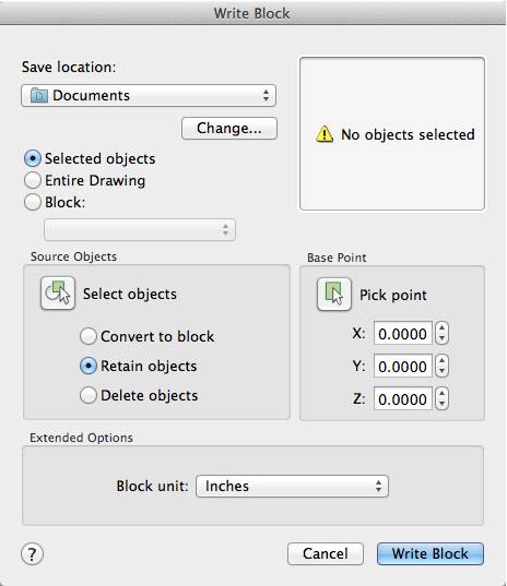

Saves objects or converts a block to a file.
The Write Block dialog box displays different default settings depending on whether nothing is selected, a single block is selected, or objects other than blocks are selected.
The following options are displayed.
Specifies the new name and location of the file and the units of measurement to be used when the block is inserted.
Specifies a file name and path where the block or objects will be saved.
Displays a standard file selection dialog box.
Displays a preview of the objects selected to be written to a drawing file.
Specifies blocks and objects, saves them as a file, and specifies insertion points.
Selects objects to save as a file. Specify a base point and select objects below.
Selects current drawing to save as another file.
Specifies an existing block to save as a file. Select a name from the list.
Sets the effect of block creation on objects used to create a block.
Temporarily closes the dialog box so that you can select one or more objects to save to the file.
Converts the selected object or objects to a block in the current drawing after saving them as a file.
Retains the selected objects in the current drawing after saving them as a file.
Deletes the selected objects from the current drawing after saving them as a file.
Specifies a base point for the block. The default value is 0,0,0.
Temporarily closes the dialog box so that you can specify an insertion base point in the current drawing.
Specifies the X coordinate value for the base point.
Specifies the Y coordinate value for the base point.
Specifies the Z coordinate value for the base point.
Specifies the unit value to be used for automatic scaling when the new file is inserted as a block in a drawing that uses different units. Select Unitless if you do not want to automatically scale the drawing when you insert it. See INSUNITS.
