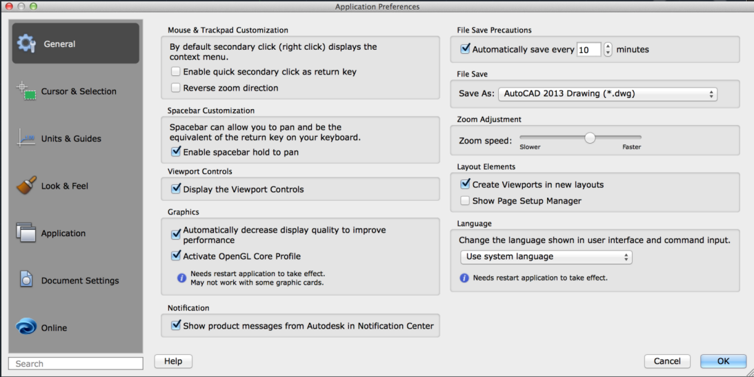

Controls the behavior of program features.
The following options are displayed.
Controls the behavior of the mouse or trackpad.
Controls right-click behavior. A quick click is the same as pressing Enter. A longer click displays a shortcut menu.
Toggles the direction of transparent zoom operations when you scroll the middle mouse wheel. (ZOOMWHEEL system variable)
Controls the behavior of the spacebar when pressed or held.
Toggles if you can hold down the Spacebar to enable panning. (SPACEPAN system variable)
Controls the display of the menus in the upper-left corner of all viewports.
Controls whether the menus for viewport tools, views, and visual styles that are located in the upper-left corner of every viewport are displayed. (VPCONTROL system variable)
Provides you the ability to activate OpenGL Core Profile if you are working in OpenGL Legacy profile.
Enables you to decrease display quality to improve performance.
Enables product messages from Autodesk in Notification Center.
Assists in avoiding data loss.
Saves your drawing automatically at the intervals you specify. You can specify the location of all Autosave files by using the SAVEFILEPATH system variable. SAVEFILE (read-only) stores the name of the Autosave file.
Minutes Between Saves: When Automatic Save is on, specifies how often the drawing is saved. (SAVETIME system variable)
Saves your drawing in a DWG and DXF format of your choice.
Provides you a list of standard drawing formats to save your drawing as.
Controls the zoom behavior of the input device.
Controls how much the magnification changes when the mouse wheel is rolled forward or backward, or you single swipe on Magic Mouse or a trackpad. (ZOOMFACTOR system variable)
Controls the tasks that the program performs when a new layout is created.
Creates a single viewport automatically when you create a new layout. (LAYOUTCREATEVIEWPORT system variable)
Displays the Page Setup Manager the first time you click a named (paper space) layout. Use this dialog box to set options related to paper and print settings. (SHOWPAGESETUPFORNEWLAYOUTS system variable)
Allows you to change the language shown in user interface and command input.
