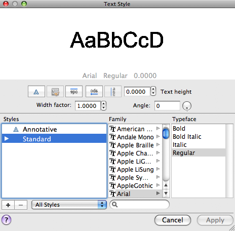

Creates, modifies, or specifies text styles.
Creates, modifies, or sets named text styles.
The following options are displayed.
Displays sample text that changes dynamically as you change fonts and modify the effects.
Modifies characteristics of the font, such as its height, width factor, and obliquing angle and whether it is displayed upside down, backwards, or vertically aligned.

Displays the list of styles in the drawing.
Style names can be up to 255 characters long. They can contain letters, numbers, and the special characters dollar sign ($), underscore (_), and hyphen (-).
Lists the font family name for all registered TrueType fonts and all compiled shape (SHX) fonts in the Fonts folder.
When you select a name from the list, the program reads the file for the specified font. The file's character definitions are loaded automatically unless the file is already in use by another text style. You can define several styles that use the same font. For more information, see “Assign Text Fonts”.
Specifies font character formatting, such as italic, bold, or regular.
When a SHX font fuile is selected from the Family list, you can select a Big Font file name from the Asian Set list.
Lists the available Big Font files when an SXH file is selected from the Family list. Select None if you do not want to use a Bif Font.
Adds a new text style to the Styles list and automatically supplies the name “ stylen” (where n is the number of the supplied style) for the current settings. You can accept the default or enter a name and close the Text Style dialog box to apply the current style settings to the new style name.
Removes the selected text style.
The drop-down list specifies whether all styles or only the styles in use are displayed in the styles list.
Filters the fonts listed in the Family list.
