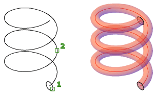

Creates a solid or surface by sweeping an open or closed, planar or non-planar curve (profile) along an open or closed path. Open curves create surfaces and closed curves create solids or surfaces, depending on the specified mode.
You can use the following objects and paths when creating a swept solid or surface:

Objects to Sweep
Specifies an object to use as the sweep profile.
Sweep Path
Specifies the sweep path based on the object you select.
