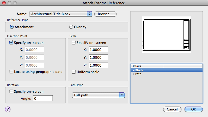

Attaches drawings as an external reference (xref).
If you attach a drawing that contains an attached xref, the attached xref appears in the current drawing. You can select multiple DWG files to attach. Like blocks, attached xrefs can be nested. If another person is currently editing the xref, the attached drawing is based on the most recently saved version.
The following options are displayed.
Identifies the DWG you have selected to attach.
Displays the Select Reference File dialog box (a standard file selection dialog box), in which you can select a new external reference for the current drawing.
Specifies whether the external reference is an attachment or an overlay. Unlike an xref that is an attachment, an overlay is ignored when the drawing to which it is attached is then attached as an xref to another drawing.
See Attach Drawing References (Xrefs) and Nest and Overlay Referenced Drawings.
Displays the DWG you have selected to attach.
Allows you to input at the Command prompt or the pointing device.
Sets the X coordinate value.
Sets the Y coordinate value.
Sets the Z coordinate value.
Sets the X scale factor.
Sets the Y scale factor.
Sets the Z scale factor.
Sets the Y and X scale factors as the same as Z.
If Specify On-Screen is selected, you may wait until you exit the dialog box to rotate the object with your pointing device or at the Command prompt.
If Specify On-Screen is cleared, enter the rotation angle value in the dialog box.
Select the full (absolute) path, the relative path to the external reference file, or No Path, the name of the external reference (the file must be located in the same folder as the current drawing file).
Displays block and path information about the external reference being attached.
Displays information about the block in the drawing.
Displays the external reference file paths.
