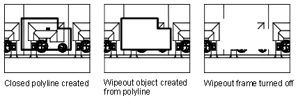

Create a polygonal area, called a wipeout to mask underlying objects with the current background color.
Use the WIPEOUT command both for creating a wipeout object, and for controlling whether wipeout frames are displayed or hidden in the drawing.
If a polyline is used to create a wipeout object, the polyline must be closed, contain line segments only, and have zero width.
