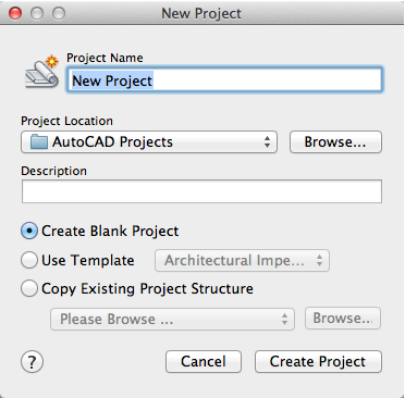

Creates a new blank project, or a project based on a project template or existing project data (DST) file.
The following options are displayed.
Specifies the name of the project.
Specifies the path of the project data (DST) file. The name of the project data (DST) file is determined by the text entered for the Project Name.
Click Browse to select a folder in Finder.
Specifies a description for the project.
Creates a new empty project using the default settings and property values.
Creates a new project based on one of the standard project template files.
A project template contains a standard set of groups, label and callout blocks, and other property values specific to an industry and unit of measurement.
Creates a new project based on an existing project data (DST) file. The new project contains all the structure, layout references, and property values of the specified project data (DST) file.
Click Browse to select a project data (DST) file in Finder.
