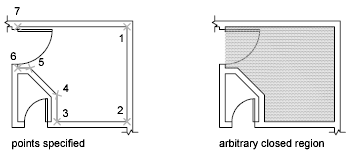

You can measure an area enclosed by the points you specify. The points must lie on a plane parallel to the XY plane of the current UCS.

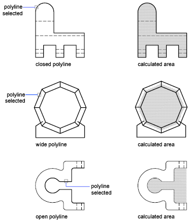

You can calculate the enclosed area and perimeter or circumference of circles, ellipses, polylines, polygons, regions, and 3D solids. The information displayed depends on the type of object selected:
