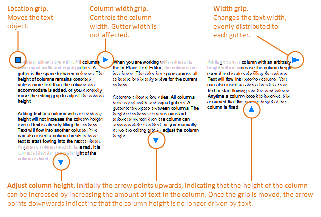

Grips control the location of the mtext object, the gutter width, and vertical and horizontal movement of columns.
The following illustration demonstrates how grips are used with Dynamic Columns - Manual Height.

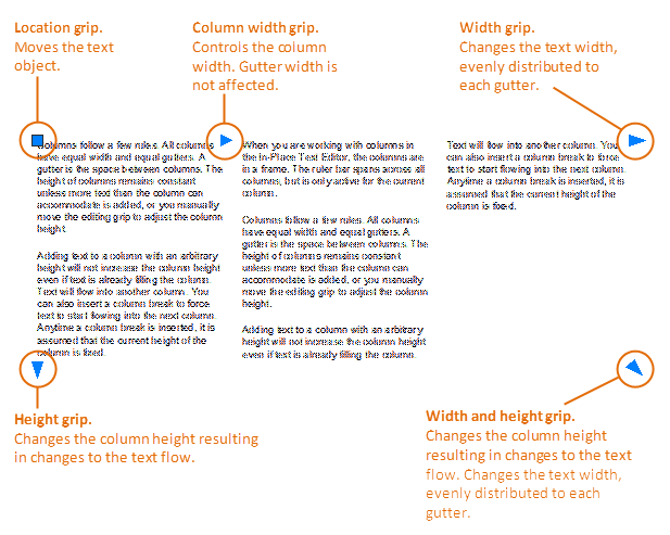

The following illustration demonstrates how grips are used with Static Columns.
