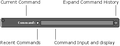

You can enter a command by using the keyboard. Some commands also have abbreviated names called command aliases.
To enter a command by using the keyboard, type the full command name or its command alias in the input area of the Command Line, and then press Enter or Spacebar. The Command Line includes several controls.

To repeat a recently used command, right-click in the Command Line or click the drop-down arrow to the left of the command input area. This action displays a shortcut menu with a list of recently used commands.
You can also repeat a recently used command by cycling through the commands with Up Arrow and Down Arrow keys, and then pressing Enter.
