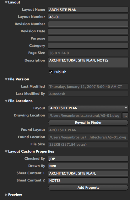

Displays information that is specific to the selected layout, such as the name, number, and whether it will be included in publishing operations. Also displays custom properties, if any.
The following options are displayed.
Displays information used to identify the layout in the project.
Displays the name of the layout in the project.
Displays the number for the layout.
Displays the revision number assigned to the layout.
Displays the revision date for the layout.
Displays what the layout is used for.
Displays the name of the category the layout.
Displays the page size for the layout.
Displays the description for the layout.
Controls whether the layout is added to the Batch Publish dialog box when publishing a group or all layouts in the project.
Lists information about the associated drawing (DWG) file.
Displays the date when the file was last modified.
Displays the name of the user who made the last modification to the file.
Displays the location of the drawing file that contains the project layout.
Specifies which named layout in the drawing (DWG) file that should be associated with the layout in the project.
The drawing (DWG) file that contains the layout is specified in the Drawing Location property.
Specifies the path to and the drawing (DWG) file name where the layout was previously saved.
Opens Finder to the location of the drawing (DWG) file associated with the layout.
Displays the name of the layout in the drawing (DWG) file associated with the layout in the project.
Displays the path and file name of the drawing where the layout was found.
Displays the size of the drawing (DWG) file associated with the layout.
Displays the user-defined custom properties associated with each layout in the project.
You can manage user-defined custom properties by:
You can also choose New Custom Property to display the Add Custom Property dialog box and create a new property.
Displays a preview image of the selected layout.
