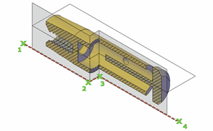

Adds a jogged segment to a section object.
Toolbar: Mesh Modeling tab
Section panel (expanded)
Section Plane JogYou can insert a jog, or angle, into a section object as you create it. The jog is created on the section line. The jogged segment is created at a 90-degree angle to the section line.
The following prompts are displayed.
Specifies which section line to modify.
Specifies the location of the jog.
