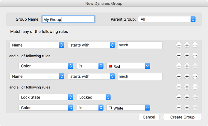

Create a Layer Group Based on Layer Properties
- In the Layers palette, click New Dynamic Layer Group.
- In the New Dynamic Group dialog, enter a name for the group.
- Specify the rules as follows:
- To group by Name, select Name, the match criteria, and enter the match value.
- To group by property, select the property and the property state.
- To group using logical AND rules, click
- To group using logical OR rules, click
In this example, the dynamic layer group includes:
- Layers that start with "mech" AND are red
OR
- Layers that start with "mech" AND are locked AND are white
