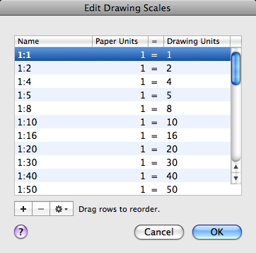

Controls the list of scales available for layout viewports, page layouts, and plotting.
The following options are displayed.
Displays the list of currently defined scales. Also displays temporary scales that are imported when xrefs are attached. If a scale name is duplicated, but has a different value, a number is appended to the name.
Creates a new scale in the scale list.
Press Tab to move between the fields of the scale being edited.
Removes the selected scale from the scale list.
Manages items in the scale list.
Edits the selected scale in-place in the scale list.
Deletes all custom scales and unused scales and restores the default list of scales.
