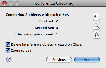

Interference Checking Dialog Box
Cycles through, zooms, and deletes or retains interference objects.
List of Options
The following options are displayed.
Interfering Objects
Displays the number of interferences found between each set during the INTERFERE command.
First Set
Displays the number of objects selected in the first set.
Second Set
Displays the number of objects selected in the second set.
Interfering Pairs Found
Displays the number of interferences found among the selected objects.
Zoom
Closes the dialog box and starts the ZOOM command.
Pan
Closes the dialog box and starts the PAN command.
3D Orbit
Closes the dialog box and starts the 3DORBIT command.
Delete Interference Objects Created on Close
Deletes the interference objects when the dialog box is closed.
Zoom to Pair
Zooms to interference objects while using Previous and Next.
Previous
Highlights the previous interference object.
Next
Highlights the next interference object.
Close
Closes the dialog box and deletes the interference objects if that option is selected.
