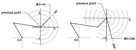

Relative coordinates are based on the last point entered. Use relative coordinates when you know the location of a point in relation to the previous point.
To specify relative coordinates, precede the coordinate values with an @ sign. For example, entering @1<45 specifies a point at a distance of 1 unit from the last point specified at an angle of 45 degrees from the X axis.
The following example shows two lines drawn with relative polar coordinates. In each illustration, the line begins at the location labeled as the previous point.
Command: line
From point: @3<45
To point: @5<285
