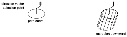

The path curve defines the approximated surface of the polygon mesh. It can be a line, arc, circle, ellipse, or 2D or 3D polyline. The mesh is drawn starting at the point on the path curve closest to the selection point.
Object for direction vector.
Specifies a line or open polyline that defines the direction of the sweep.
Only the first and last points on a polyline are considered, and intermediate vertices are ignored. The direction vector indicates the direction and length of the shape to be extruded. The end selected on the polyline or line determines the direction of the extrusion. The original path curve is drawn with wide lines to help you visualize how the direction vector dictates the construction of a tabulated mesh.
