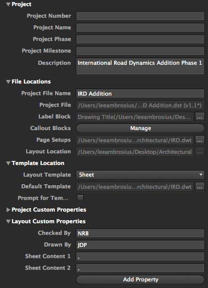

Displays information that is specific to the project.
The following options are displayed.
Displays fields commonly used to identify a project.
Specifies the number assigned to the project.
Specifies the name assigned to the project.
Specifies the current phase of the project.
Specifies the current milestone of the project.
Specifies a description of the project.
Displays the paths for the project, page setup overrides, and the callout and label blocks used by the project.
Specifies the name of the project.
Displays the path and file name of the project data (DST) file.
Displays the path and file name of the drawing template (DWT) or drawing (DWG) file that contains the label block for the project.
Click the Ellipsis button to display the Label Block for Views dialog box and specify a label block for the project.
Click Manage to display the Callout Blocks dialog box and manage the callout blocks for the project.
Displays the path and file name for the drawing template (DWT) file containing the page setup overrides for the project.
Click the Ellipsis button to specify the drawing template (DWT) file that contains the page setup overrides to use for the project.
Displays the path and name of the folder where new drawing (DWG) files are saved when new layouts are created.
Displays settings used when creating a new layout in the current project.
Displays the layout to use when creating a new layout.
The layouts displayed in the drop-down list come from the file specified in the Default Template property.
Specifies the drawing template (DWT) or drawing (DWG) file to use when creating new drawing files for the group.
Controls whether the New Project Layout dialog box is displayed in the expanded or collapsed state each time a new layout is added.
Displays the user-defined custom properties associated with the project.
You can manage user-defined custom properties by:
You can also choose New Custom Property to display the Add Custom Property dialog box and create a new property.
Displays the user-defined custom properties associated with each layout in the project.
