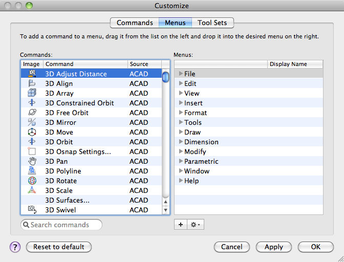

Creates and manages the menus and menu items on the Mac OS menu bar.
The following options are displayed.
Displays a list of the standard and custom commands that can be added to menus and tool sets. You must be on the Commands tab if you want to create or edit a command.
Drag the command to the location in the menu you want it positioned and drop it. The location of the command is indicated by the horizontal bar. If you hover over a menu or sub-menu while dragging a command, the menu or sub-menu will expand after a short interval.
Filters the commands displayed in the Commands list. Click the ‘X’ in the text box to clear the current filter.
Enter a text string to control which commands are displayed in the Commands list. Only the names of the commands that contain the text string are displayed in the Commands list.
Lists the menus available on the Mac OS menu bar. Expand a menu to see the commands and sub-menus that are assigned to the menu.
Displays a menu which allows you to create a new menu or sub-menu.
Displays a menu which allows you to manage the commands and sub-menus in a menu.
