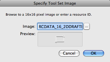

Assigns an external image or internal resource to a tool set.
The following options are displayed.
Displays the name of the resource or external image file that is assigned to the tool set.
Click […] to display the Select an Image File dialog box and specify the external image to assign to the tool set.
Displays a thumbnail of the selected image.
