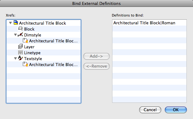

Adds xref-dependent named objects (such as blocks, dimension styles, layers, linetypes, and text styles) to your drawing.
The following options are displayed.
Lists the xrefs currently attached to the drawing. Selecting an xref (double-clicking) displays the named object definitions in the attached xref.
Lists the xref-dependent named object definitions to bind to the host drawing.
Moves the named object definitions selected in the Xrefs list into the Definitions to Bind list.
Moves the xref-dependent named object definition selected in the Definitions to Bind list back to its xref-dependent definition table.
