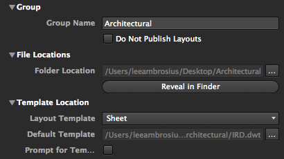

Displays information that is specific to the selected group.
The following options are displayed.
Displays the name and if the group is included when publishing.
Displays the name of the group.
Controls whether the layouts in the group are added to the Batch Publish dialog box when publishing the group or all layouts in the project.
Displays information about the folder on disk that the group represents in the project.
Specifies the folder location for new drawing (DWG) files created as a result of adding a new layout to the group.
Does not impact the folder location of a drawing (DWG) file when adding layouts from an existing drawing.
Displays the resolved absolute path to the folder on disk that the group represents.
Displays settings used when creating a new layout in the group.
Displays the layout to use when creating a new layout.
The layouts displayed in the drop-down list come from the file specified in the Default Template property.
Specifies the drawing template (DWT) or drawing (DWG) file to use when creating new drawing files for the project.
Controls whether the New Project Layout dialog box is displayed in the expanded or collapsed state each time a new layout is added.
