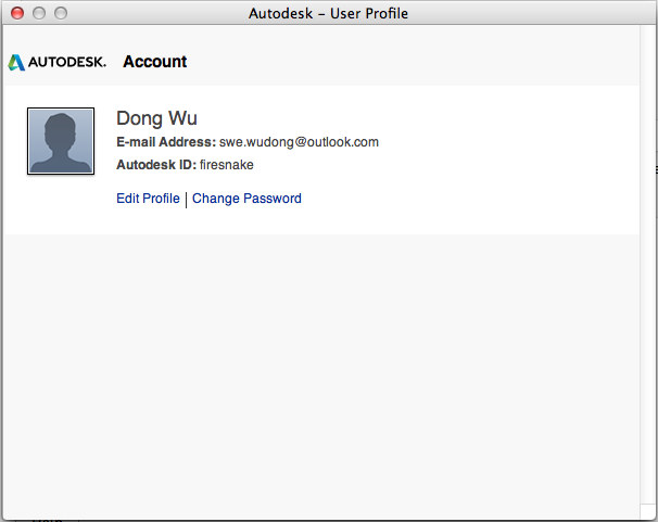

Account Settings Dialog Box
Controls settings of your Autodesk 360 account information.
