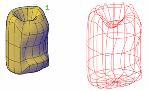

Creates wireframe geometry from the edges of a 3D solid, surface, mesh, region, or subobject.

With the XEDGES command, you can create wireframe geometry by extracting all the edges from the following objects:
Press and hold Ctrl to select faces, edges and component objects, repeating if necessary. Objects such as lines, arcs, splines, or 3D polylines are created along the edges of the selected objects or subobjects.
