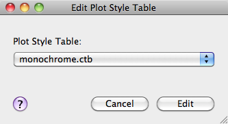

Create or edit plot style table files.
The following options are displayed.
Displays a list of the available plot style files that can be edited. A plot style is a collection of property settings used in plotting. Along with selecting a plot style to edit from the list, you can also select one of the following:
Plot Style Table Search Path on the Application tab of the Application Preferences dialog box (OPTIONS command). Displays the Plot Style Table Editor with the properties of the selected plot style.
