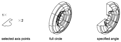

Specifies the first point of the axis of revolution. The positive axis direction is from the first to the second point.
Sets the endpoint for the axis of revolution.
Specifies an offset for the revolution from the plane of the object being revolved.
Drag your cursor to specify and preview the start angle of the object.
Specifies how far the selected object revolves about the axis.
A positive angle revolves the objects in a counterclockwise direction. A negative angle revolves the objects in a clockwise direction. You can also drag the cursor to specify and preview the angle of revolution.

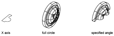

Sets the positive X axis of the current UCS as the positive axis direction.
Sets the positive Y axis of the current UCS as the positive axis direction.
Sets the positive Z axis of the current UCS as the positive axis direction.
