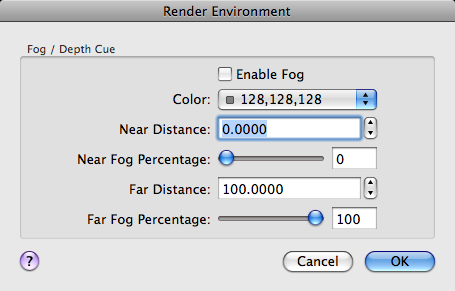

Render Environment Dialog Box
Defines the cues for distance between objects and the current viewing direction.
Summary
Fog and depth cueing are atmospheric effects that cause objects to appear to fade as they increase in distance from the camera. Fog uses a white color while depth cueing uses black.
List of Options
The following options are displayed.
Fog and Depth Cue
Enable Fog
Turns fog on and off without affecting the other settings in the dialog box.
Color
Specifies the color of the fog.
Near Distance
Specifies the distance from the camera where the fog begins.
It is specified as a percentage of the distance to the far clipping plane. The Near Distance setting cannot be greater than the Far Distance setting.
Far Distance
Specifies the distance from the camera where the fog ends.
It is specified as a percentage of the distance to the far clipping plane. The Far Distance setting cannot be less than the Near Distance setting.
Near Fog Percentage
Specifies the opacity of the fog at the near distance.
Far Fog Percentage
Specifies the opacity of the fog at the far distance.
