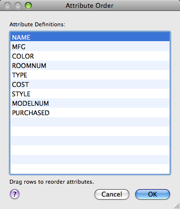

Specifies the order in which attributes are listed and prompted for when you insert or edit a block reference.
The following options are displayed.
Lists the attribute definitions in the current block.
Drag an attribute definition up or down in the list to reorder it.
