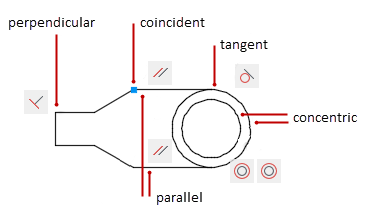

You can apply geometric constraints to associate 2D geometric objects together, or specify a fixed location or angle.
For example, you can specify that a line should always be perpendicular to another one, that an arc and a circle should always remain concentric, or that a line should always be tangent to an arc.

With some constraints, you can specify constraint points on objects instead of selecting the objects. This behavior is similar to that of object snaps, but the locations are limited to endpoints, midpoints, center points, and insertion points. For example, a coincident constraint can restrict the location of the endpoint of one line to the endpoint of another line.
The following glyph displays on an object as your cursor rolls over it. In this case, it indicates that the next constraint will be applied to the left endpoint of the horizontal line.

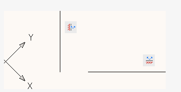

A different set of constraint bar icons are displayed when a horizontal or vertical constraint is not parallel or perpendicular with the current UCS.
