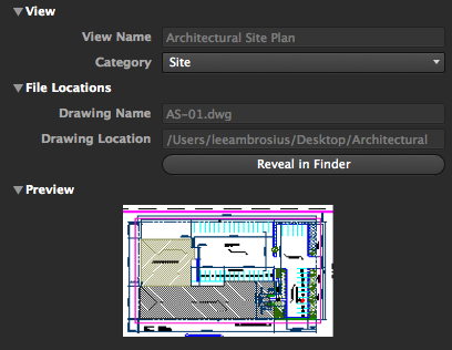

Displays information that is specific to the selected view.
Views represent named views that have been placed on a layout in the current project using the Sheet Set Manager in AutoCAD for Windows. Views cannot be modified or placed using the Project Manager.
The following options are displayed.
Displays information about the view.
Assigns a category to the view.
The Category list is populated by the current value of each model space view's View Category property when it was placed on a layout in the project.
Displays information about the drawing file that the view is located in.
Displays a preview image of the selected view.
