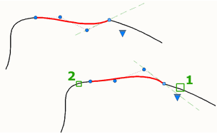

Select each object near an endpoint. The shape of the resulting spline depends on the specified continuity. The lengths of the selected objects remain unchanged.
Valid objects include lines, arcs, elliptical arcs, helixes, open polylines, and open splines.
The following prompts are displayed.
Select first object or [CONtinuity]: Select a line or open curve near the end where the spline should start
Select second object: Select another line or open curve near the end where the spline should end
Specify one of two types of blends.
Creates a degree 3 spline with tangency (G1) continuity to the selected objects at their endpoints.
Creates a degree 5 spline with curvature (G2) continuity to the selected objects at their endpoints.
