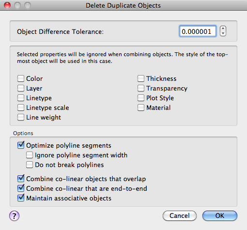

Removes duplicate geometry as well as overlapping lines, arcs, and polylines. Also, combines partially overlapping or contiguous ones.
The following options are displayed.
Controls the precision with which OVERKILL makes numeric comparisons. If this value is 0, the two objects being compared must match before OVERKILL modifies or deletes one of them.
Use these settings to determine which object properties are ignored during comparison.
Object color is ignored.
Object layers are ignored.
Object linetypes are ignored.
Object linetype scale is ignored.
Object lineweight is ignored.
Object thickness is ignored.
Object transparency is ignored.
Object plot style is ignored.
Object material is ignored.
Use these settings to control how OVERKILL deals with lines, arcs, and polylines.
When selected, individual line and arc segments within selected polylines are examined. Duplicate vertices and segments are removed.
Also, OVERKILL compares individual polyline segments with completely separate line and arc segments. If a polyline segment duplicates a line or arc object, one of them is deleted.
If this option is not selected, polylines are compared as discreet objects and two sub-options are not selectable.
Overlapping objects are combined into single objects.
Objects that have common endpoints are combined into single objects.
Associative objects are not deleted or modified.
