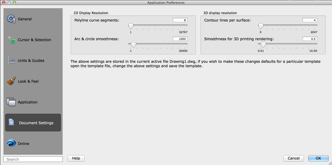

Document Settings Tab (Application Preferences Dialog Box)
Controls the display settings for a drawing.
List of Options
The following options are displayed.
2D Display Resolution
Controls the display of 2D objects.
Polyline Curve Segments
Sets the number of line segments to be generated for each spline-fit polyline generated by the Spline option of the PEDIT command. (SPLINESEGS system variable)
Arc & Circle Smoothness
Sets the resolution for objects in the current viewport. (VIEWRES command)
3D Display Resolution
Controls the display of 3D objects.
Contour Lines per Surface
Specifies the number of contour lines per surface on objects. (ISOLINES system variable)
Smoothness for 3D Printing and Rendering
Adjusts the smoothness of shaded and rendered objects and objects with hidden lines removed. (FACETRES system variable)
