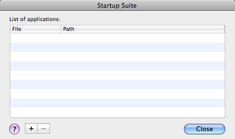

Adds and removes application files from the Startup Suite. These are the applications that are loaded each time you start AutoCAD.
The following options are displayed.
Displays an alphabetical list (by file name) of the application files to load at startup.
Displays the Add File to Startup Suite dialog box. You can use this dialog box to select files to add to the startup suite.
Removes selected files from the Startup Suite.
