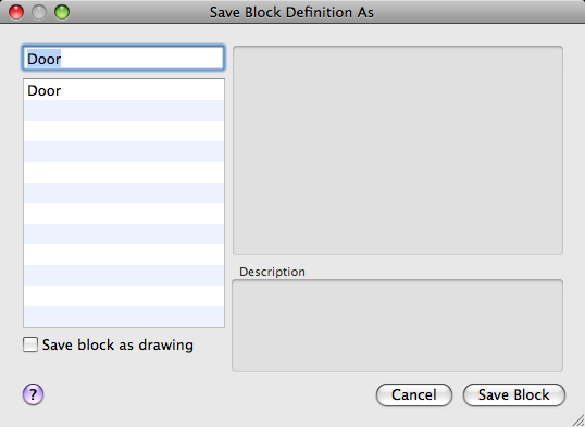

Saves a copy of the current block definition under a new name.
The following options are displayed.
Specifies a new name under which to save a copy of the current block definition.
Saves the geometry in the Block Editor as a drawing file. Selecting an existing drawing file on disk overwrites the file. By default, the block name specified is used as the drawing file name.
Displays a list of block definitions that are saved in the current drawing.
Displays a preview of the selected block definition.
Displays the description saved with the block definition.
