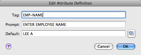

Edits an attribute text object.
The following options are displayed.
Specifies the attribute tag, which identifies the attribute in the drawing. The tag can contain exclamation marks (!). The case change is not immediately displayed in the tag field.
Specifies the attribute prompt that is displayed when you insert a block containing this attribute definition.
Specifies the default attribute value.
To use a field as the value, right-click and click Insert Field on the shortcut menu to display the Insert Field dialog box.
