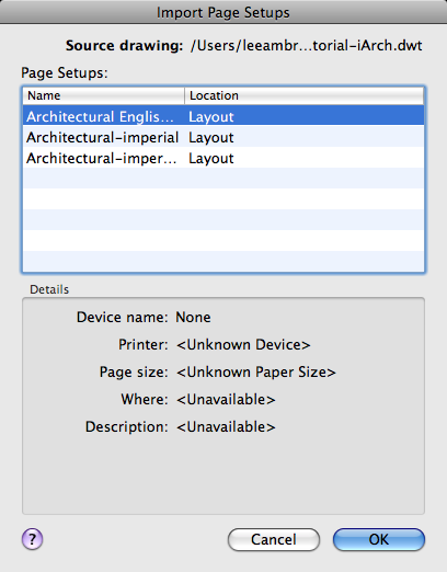

Displays the page setups in the selected drawing that are available to import.
The following options are displayed.
Displays the source drawing that contains the listed page setups that are available to import.
Lists the page setups that are available to import and their location in the source drawing. Selected page setups are imported into the current drawing when you click OK.
When you import page setups into a page setup overrides file for a sheet set, only page setups with Plot Area set to Layout or Extents are listed.
Specifies the name of the page setup available to import.
Specifies the location (Model or named layout) of the page setup in the drawing from which you are importing the page setup.
Displays information about the selected page setup.
Displays the name of the plot device specified in the currently selected page setup.
Displays the type of output device specified in the currently selected page setup.
Displays the paper size and orientation specified in the currently selected page setup.
Displays the physical location of the output device specified in the currently selected page setup.
Displays descriptive text about the output device specified in the currently selected page setup.
