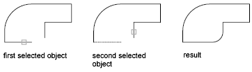

Summary
In the example, an arc is created that is tangent to both of the selected lines. The lines are trimmed to the ends of the arc. To create a sharp corner instead, enter a radius of zero.

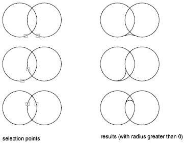

More than one fillet can exist between arcs and circles. Select the objects close to where you want the endpoints of the fillet.
FILLET does not trim circles; the fillet arc meets the circle smoothly.

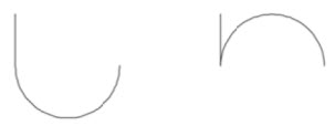

Polyline
Inserts fillet arcs at each vertex of a 2D polyline where two line segments meet.
Select 2D polyline:
If one arc segment separates two line segments that converge as they approach the arc segment, FILLET removes the arc segment and replaces it with a fillet arc.
