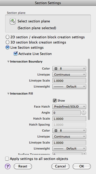

Section Settings Dialog Box
Sets display options for section planes.

Section Plane
If a section plane has not been selected, specifies a selection plane to be modified.
Select Section Plane
Temporarily closes the Section Settings dialog box so that you can select a section object in the drawing area.
Setting Type
Specifies which setting types are displayed in the properties list.
2D Section / Elevation Block Creation Settings
Determines how a 2D section from a 3D object is displayed when generated.
3D Section Block Creation Settings
Determines how a 3D object is displayed when generated.
Live Section Settings
Determines how sectioned objects are displayed in the drawing when live sectioning is turned on.
Activate Live Section
Turns on live sectioning for the selected section object.

Apply Settings to All Section Objects
When selected, applies all the settings to all section objects in the drawing. When cleared, applies settings to the current section object only.
Reset
Resets all settings in the dialog box to their default values.
