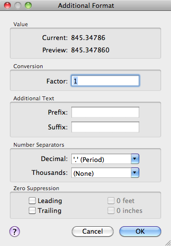

Provides additional formatting options for fields and table cells.
The following options are displayed.
Displays the value in base drawing units, and reflects the value as it will appear once the conversion factor and other settings are applied.
Specifies the conversion factor to use on the current value. The default is 1 for no conversion.
Specifies a prefix or a suffix for the value.
Specifies a decimal separator and the formatting for numbers over 1000.
Specifies the separator for decimal values. Select a period, a comma, or a space.
Inserts a comma to group thousands in a field value.
Controls the suppression of leading and trailing zeros, and of feet and inches that have a value of zero.
Suppresses leading zeros in all decimal values. For example, 0.5000 becomes .5000.
Suppresses trailing zeros in all decimal values. For example, 12.5000 becomes 12.5, and 30.0000 becomes 30.
Suppresses the feet portion of a feet-and-inches value when the distance is less than one foot. For example, 0'-6 1/2" becomes 6 1/2".
Suppresses the inches portion of a feet-and-inches value when the distance is an integral number of feet. For example, 1'-0" becomes 1'.
