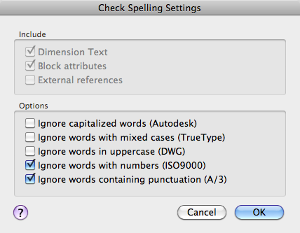

Provides options to change the way the default behavior of the spelling checker in the In-place Text editor.
Specifies specific text options that will be checked in your drawing.
The following options are displayed.
Searches dimension text.
Searches block attributes text for spelling errors.
Specifies to search external references for spelling errors.
Specifies to ignore capitalized words.
Specifies to ignore words that contain uppercase and lowercase letters.
Specifies to ignore words that are in all uppercase.
Specifies to ignore words that include numbers.
Specifies to ignore words that contain punctuation.
