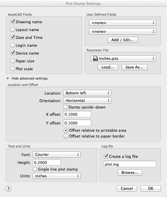

Specifies the information for the plot stamp.
The following options are displayed.
Specifies the drawing information you want applied to the plot stamp. The selected fields are separated by commas and a space.
Includes the drawing name and path in the plot stamp information.
Includes the name of the layout in the plot stamp information.
Includes the date and time in the plot stamp information.
Includes the user login name in the plot stamp information.
The user login name is contained in the LOGINNAME system variable.
Includes the current plotting device name in the plot stamp information.
Includes the paper size for the currently configured plotting device in the plot stamp information.
Includes the plot scale in the plot stamp information.
Provides text that can optionally be plotted, logged, or both plotted and logged at plot time. The selected value in each user-defined list will be plotted.
For example, you might populate one list with media types or prices and the other with job names. If the user-defined value is set to <none>, then no user-defined information is plotted
Displays the Add User Defined Fields dialog box, where you can add, edit, or delete user-defined fields.
Stores plot stamp information in a file with a .pss extension. Multiple users can access the same file and stamp their plots based on company standard settings.
Two PSS files are provided, Mm.pss and Inches.pss, which are located in the Support folder. The initial default plot stamp parameter file name is determined by the regional settings of the operating system when the program is installed.
Specifies the location of the plot stamp parameter file.
Displays the Plotstamp Parameter File Name dialog box (a standard file selection dialog box) in which you can specify the location of the parameter file you want to use.
Saves the current plot stamp settings in a new parameter file.
Expands or collapses the Advanced Settings section towhich contains placement and text options for the plot stamp.
Determines the plot stamp location, the orientation of the plot stamp, and the offset you want to apply relative to either the printable area or the paper border.
Indicates the area where you want to place the plot stamp. Selections include Top Left, Bottom Left (default), Bottom Right, and Top Right. The location is relative to the image orientation of the drawing on the page.
Indicates the rotation of the plot stamp in relation to the specified page. The options are Horizontal and Vertical for each of the locations (for example, Top Left Horizontal and Top Left Vertical).
Rotates the plot stamp upside down.
Determines the X offset value that is calculated from either the corner of the paper or the corner of the printable area, depending on which setting you specify. If you specify Offset Relative to Paper Border, the offset value is calculated so that the plot stamp information fits within the paper size.
Determines the Y offset value that is calculated from either the corner of the paper or the corner of the printable area, depending on which setting you specify. If you specify Offset Relative to Paper Border, the offset value is calculated so that the plot stamp information fits within the paper size.
Calculates the offset values that you specify from the corner of the printable area of the paper (not the corner of the paper).
Calculates the offset values that you specify from the corner of the paper (not the corner of the printable area of the paper).
Determines the font, height, and number of lines you want to apply to the plot stamp text.
Specifies the TrueType font you want to apply to the text used for the plot stamp information.
Specifies the text height you want to apply to the plot stamp information.
Places the plot stamp information in a single line of text. The plot stamp information can consist of up to two lines of text, but the placement and offset values you specify must accommodate text wrapping and text height. If this option is cleared, plot stamp text is wrapped after the third field.
Specifies the units to use to calculate the height of the text: inches, millimeters, and pixels.
Writes the plot stamp information to a log file instead of, or in addition to, stamping the current plot. If plot stamping is turned off, the log file can still be created.
Writes the plot stamp information to a log file. The default log file is plot.log, and it is located in the main application folder.
You can specify a different file name and path. After the initial plot.log file is created, the plot stamp information in each succeeding plotted drawing is added to this file. Each drawing's plot stamp information is a single line of text. The plot stamp log file can be placed on a network drive and shared by multiple users. Plot stamp information from each user is appended to the plot.log file.
Specifies the file name for the log file you are creating. Enter a new file name if you do not want to use the default file name, plot.log.
Lists the currently saved plot stamp log files. You can choose to overwrite an existing plot stamp log file with the currently specified plot stamp information, and then to save this file.
