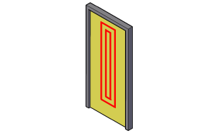

Imprints 2D geometry on a 3D solid or surface, creating additional edges on planar faces.

2D geometry located on a face or the intersection of a 3D solid with a face can be combined with that face to create additional edges. These edges can provide a visual effect, and can be pressed and pulled to create indentations and extrusions.
