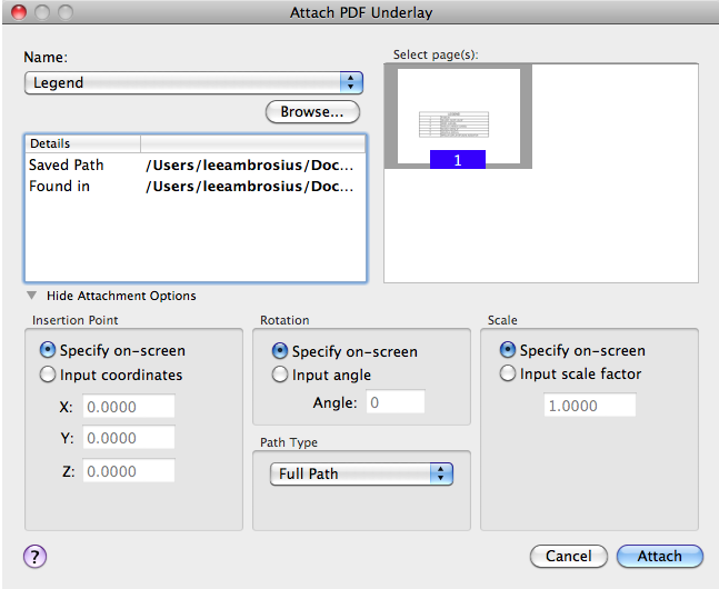

Names, locates, and defines the insertion point, scale, and rotation of attached PDF underlays.
The following options are displayed.
Identifies the PDF file you have selected to attach.
Opens the Select Reference File dialog (a standard file selection dialog box).
Displays the path that is saved with the drawing when the PDF file is attached. The path is dependent upon the Path Type setting.
Displays the path to the PDF file.
Displays all of the pages that are found in the PDF file. If the PDF file only contains a single page, that page is listed. You can select multiple pages by holding Shift or Cmd and selecting the pages to attach.
Expands or collapses the Attachment Options section to allow you to specify the insertion point, rotation and scale for the PDF underlay being attached.
Specifies the insertion point for the selected PDF file.
Directs input at the Command prompt or the pointing device.
Sets the X coordinate value.
Sets the Y coordinate value.
Sets the Z coordinate value.
Specifies the rotation angle of the selected PDF underlay.
If Specify On-Screen is selected, you may wait until you exit the dialog box to rotate the object with your pointing device or enter a rotation angle value at the Command prompt.
If Specify On-Screen is cleared, enter the rotation angle value in the dialog box. The default rotation angle is 0.
Select the full (absolute) path, the relative path to the PDF file, or No Path, and the name of the PDF file. For the No Path option, the PDF file must be located in the same folder as the current drawing file.
Specifies the scale factor of the selected PDF underlay.
If INSUNITS is set to “unitless” or if the underlay does not contain resolution information, the scale factor becomes the underlay width in AutoCAD units. If INSUNITS has a value such as millimeters, centimeters, inches, or feet, and the underlay has resolution information, the scale factor is applied after the true width of the underlay in AutoCAD units is determined.
Inputs information at the Command prompt or with the pointing device. If Specify On-Screen is cleared, enter a value for the scale factor.
Enter a value for the scale factor.
