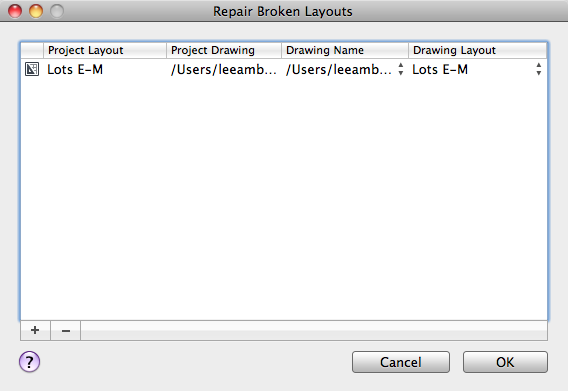

Updates the location of the layouts and drawing (DWG) files referenced by the project layouts in the current project.
The following options are available.
Current status of the layout in the project: missing or resolved.
Name of each missing layout in the current project.
Drawing (DWG) file name in which the project layout is contained in.
List of all the drawing (DWG) files that are referenced in the project or added to the dialog box using the Add Drawing (+) button.
Lists all the layouts in the drawing selected from the Drawing Name list.
Adds a drawing to the Drawing Name list.
Removes a drawing currently not referenced by the project.
