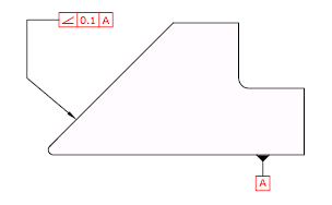

Creates geometric tolerances contained in a feature control frame.
Button
Toolbar: Annotation tool set
Dimensions tool group (expanded)
Tolerance
Menu:
Dimension
Tolerance
The Geometric Tolerance dialog box is displayed.
Geometric tolerances show acceptable deviations of form, profile, orientation, location, and runout. Feature control frames can be created with leader lines using TOLERANCE, LEADER, or QLEADER.
