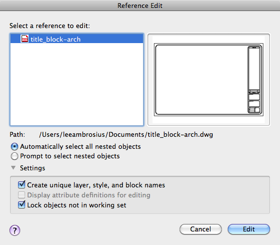

Specifies the reference to edit.
To select a reference to edit, select an object in the reference. If you select an object that is part of one or more nested references, the nested references are displayed in the dialog box.
The following options are displayed.
Displays the reference selected for in-place editing and any references nested within the selected reference.
Nested references are displayed only if the selected object is part of a nested reference. If multiple references are displayed, choose a specific xref or block to modify. Only one reference can be edited in place at a time.
Displays a preview image of the currently selected reference.
The preview image displays the reference as it was last saved in the drawing. The reference preview image is not updated when changes are saved back to the reference.
Displays the file location of the selected reference. If the selected reference is a block, no path is displayed.
Specifies how the selection of nested objects should be handled.
Controls whether nested objects are included automatically in the reference editing session.
If this option is checked, all the objects in the selected reference will be automatically included in the reference editing session.
Controls whether nested objects must be selected individually in the reference editing session.
If this option is checked, after you close the Reference Edit dialog box and enter the reference edit state, you are prompted to select the specific objects in the reference that you want to edit.
Select nested objects: Select objects within the reference that you want to edit
Provides options for editing references.
Controls whether layers and other named objects extracted from the reference are uniquely altered.
If selected, named objects in xrefs are altered (names are prefixed with $#$), similar to the way they are altered when you bind xrefs. If cleared, the names of layers and other named objects remain the same as in the reference drawing. Named objects that are not altered to make them unique assume the properties of those in the current host drawing that share the same name.
Controls whether all variable attribute definitions in block references are extracted and displayed during reference editing.
If Display Attribute Definitions for Editing is selected, the attributes (except constant attributes) are made invisible, and the attribute definitions are available for editing along with the selected reference geometry. When changes are saved back to the block reference, the attributes of the original reference remain unchanged. The new or altered attribute definitions affect only subsequent insertions of the block; the attributes in existing block instances are not affected. Xrefs and block references without definitions are not affected by this option.
Locks all objects not in the working set. This prevents you from accidentally selecting and editing objects in the host drawing while in a reference editing state.
The behavior of locked objects is similar to objects on a locked layer. If you try to edit locked objects, they are filtered from the selection set.
